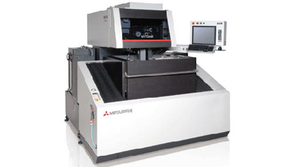

Mitsubishi EDM’s newest MV wire machines feature design and engineering improvements that exceed all other wire EDM machines on the market, including: non-contact cylindrical drive technology, an improved power supply, auto-threading, deeper submerged-wire threading capabilities, and more.
The new cylindrical drive technology offers a simple yet intelligent design concept using a linear shaft motor. Other EDMs built on a linear system are a flat-plate design, which limits the effective magnetic flux to only half of its potential. Mitsubishi’s round magnetic shaft creates a non-contact design using the full 360 degrees of magnetic flux. This design delivers no wear, no cogging (inherent in flat plate systems), and no backlash – all for better energy-efficiency, accuracy, and speed.
