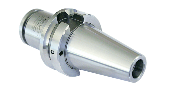

Licensed by BIG Daishowa, dual contact REGO PLUS products are compatible with all BIG PLUS spindles, and include a full line of ER and powRgrip system toolholders. These products offer several advantages to manufacturers working with high-precision milling machines equipped with the BIG PLUS system, including better TIR, improved tool rigidity, increased quality of surface finishes and higher machine accuracies.
