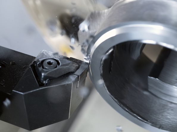

Products on display will include Duratomic TK insert grades for cast iron turning, Duratomic DP3000 heat-resistant inserts for Perfomax Indexable Drills, the Square 6 - 04 shoulder milling cutter, the Turbo 10 cutting tool, the Double Octomill - 05 face milling cutter for smaller machines and a new generation of disc milling cutters for large slot width.
The TK1001 and TK2001 insert grades, featuring Duratomic coating process technology, offer high performance turning, allow for faster cutting speeds and increased tool life, and effectively reduce the number of grades needed in cast iron applications. TK1001 effectively tackles gray cast iron from finishing up to semi-stable conditions and nodular cast iron under stable conditions as well as hardened steels in the 40 – 45 Rc range. The TK2001 steps in for the successful machining of nodular cast iron and gray cast iron in tougher applications, all the way to heavy interrupted cuts. The TK grades are available in 211 new geometries and chip grooves, ensuring applicability across a broad range of operations.
