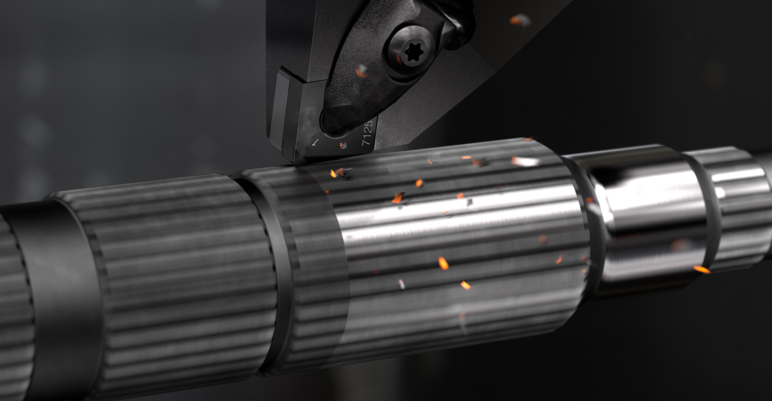

Tool and insert materials — It pays to be mindful of the tool and insert materials you choose as well. Carbide resists deflection when machining hard items, but make sure it's solid carbide. Plated carbide tools can sometimes chip easily. Ceramic tools are another popular choice for hard machining.
Cubic boron nitride (CBN) inserts are an alternative that has gained popularity as product designs have called for harder materials. For example, sintered metals are extra-hard and feature microstructures that cause “microchatter” and early insert failure. Carbide inserts may fail under pressure, but CBN inserts (containing titanium and tungsten carbides) will not.
