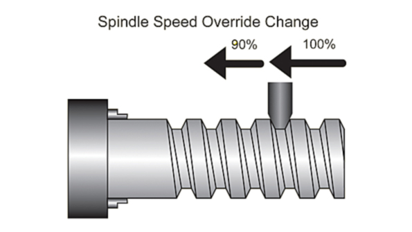

Arbitrary speed threading allows operators to adjust the spindle speed during thread cutting to control chatter. Also, it establishes quick rethreading functionality, and the ability to repair existing threads. According to Fanuc, these capabilities make arbitrary speed threading a valuable option for pipe and fitting thread maintenance in oil-and-gas industry machining.
The CNC developer added that arbitrary speed threading allows machine operators to adjust the spindle speed during a threading cycle to eliminate vibration and chatter. This is a valuable feature during thread repair because chatter is more likely to occur with the small amounts of material typically being removed.
Without arbitrary speed threading, the spindle speed override is inhibited during threading, to prevent damaging the part, as a change in thread lead would occur.
With arbitrary speed threading, the cutting tool remains coordinated with the spindle speed at all times during threading to produce the programmed lead.
