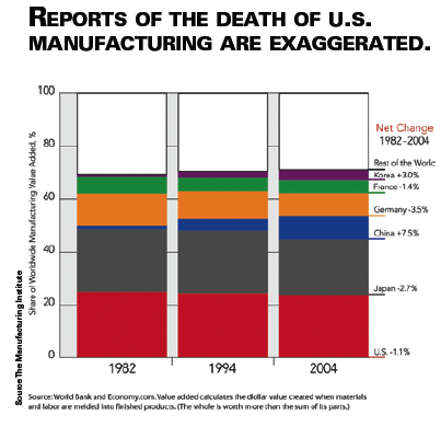

The above chart compares global manufacturing levels from 1982 through 2004. United States is the world's number one manufacturer, accounting for about a quarter of global manufacturing output in 2004. Its global share has barely dipped (down 1.1 percent) in the past two decades, while manufacturing in Germany, Japan and France did fare nearly as well. While industrialized countries' share of manufacturing value added fell slightly in the past two decades, China and Korea's share of manufacturing output has risen.
