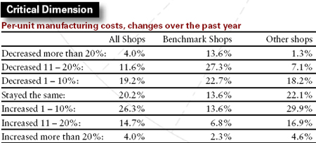

All shops are under pressure from rising costs and demands from customers to keep their prices down. One of the areas that benchmark shops report doing well is in maintaining low per-unit manufacturing costs. Over the past year, per-unit costs decreased for the majority of benchmark shops, while they increased for other shops.
Meanwhile, benchmark shops were able to push their net profit to a median number of 14.9 percent, compared with 12 percent for other shops. That is partly based on higher shop revenue per man hour – the amount of revenue that a shop takes in after its total labor costs are discounted. The benchmark shops said they see about $9 more per man hour in shop revenues than the other shops, based on the median numbers they reported.
