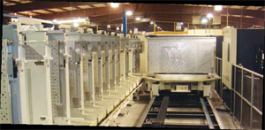

Fully automated cells let Weaver Manufacturing machine its larger parts in the least amount of clampings possible.

Weaver has a total of 31 spindles, 14 of which are housed in the company’s south building. The building’s 5-axis machining cells include one that consists of a Mazak Variaxis trunion-style machine with an RGV that tends a 24-pallet work loading system, and another cell that has multiple Makino MAG 3 machines that are supported by 16 pallets, each of which measure 60 in. by 120 in.
Both of those machining cells provide full, infinite C-axis rotation that allows Weaver to do more machining without having to reposition parts. May said that ability also produces higher quality parts.
Cell pallet systems run in full automatic mode. The shop loads several jobs into the cell controller, and lets it handle job-run scheduling based on due dates and priorities.
The MAG 3 machine tables are horizontally orientated for part loading. They then move to an upright vertical position inside the machine. That setup is especially advantageous for large amounts of metal removal, as is the case with Weaver’s large, aluminum monolithic aerospace parts.
