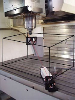

A cutting tool in a machine’s spindle would trace/follow a cube-shaped path during sequential step diagonal measuring for 3D volumetric errors.
Optodyne’s system orientates laser beams diagonally for its sequential step diagonal measuring system.

Instead of aligning a laser beam and its reflector/target straight along a machine axis, as with conventional laser interferometer measuring, shops that use Optodyne’s system position the laser beam in a direction diagonal to the machine’s axes. However, instead of moving the X, Y, and Z axes (for a 3-axis machine) simultaneously along the diagonal direction, the sequential step diagonal method requires that only the X axis be moved, then stopped. Data is collected, then the machine is moved in the Y axis. Data is collected again, and the machine is moved in the Z axis and data is collected. These movements and data collections are repeated until the opposite diagonal corner is reached.
If there was a tool in the machine’s spindle, Wang said it would trace a cubeshaped path through the sequential step diagonal measuring process. He also said that moving the axes separately provides three times more data than if they are moved simultaneously as with conventional laser interferometer methods.
