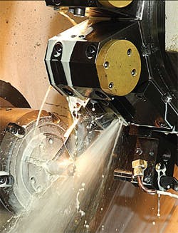

The two main functions of metalworking coolants are to cool the tool and reduce friction in the cut.
Also important, are clearing of chips, inhibiting corrosion, providing biostability and providing an operator-friendly environment. Coolants are complex chemical formulations created to meet these performance requirements.
