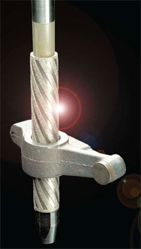

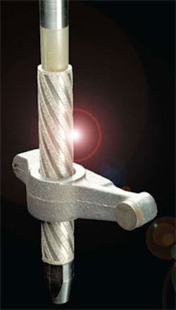

The cutting surfaces of this single-pass honing mandrel from Sunnen Products Co. (www.sunnen.com) are made by mechanically attaching the diamond abrasive to the tool substrate using a nickel-plating process.
