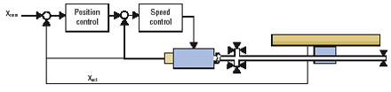

Almost all machine tools incorporate recirculating ballscrews that convert rotary servomotor motion into linear slide motion. Axis-position control comes from either rotary encoders in conjunction with recirculating ballscrews or linear encoders affixed to machine slides.
A position-control loop with a rotary encoder and ballscrew, called semiclosed-loop control, includes only a servomotor with no actual position control on the slide. The position of the servomotor rotor is controlled using the pitch of the ballscrew as the measuring standard. To extrapolate the slide position with this arrangement, the mechanical system between the servomotor and slide must have a known and reproducible mechanical-transfer behavior.
A position-control loop with linear encoders — closed-loop control — includes the entire mechanical feed-drive system. With line grating on linear scales as the measuring standard, linear encoders on slides detect mechanical-transmission errors, which are compensatedby machine-control units.

Typical drive system of an NC machine tool with a linear scale on the slide (closed-loop control) and rotary encoder/ballscrew system (semiclosed-loop control).
