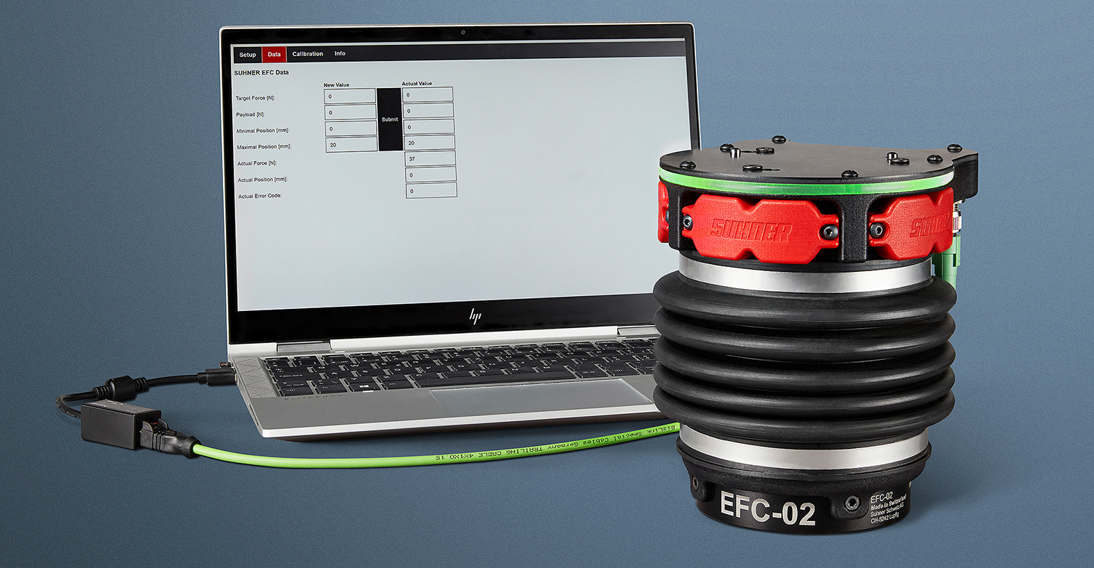

As with any end-of-arm tooling, the EFC-02 connects a grinding machine – angle grinders, orbital sanders, angle polishers, straight grinders and others – to the robot. What distinguishes the device is its compact design and fully electric operation.
The lightest and smallest in its category, the EFC-02 can be used for material removal or surface finishing even in tight or narrow spaces often found when processing stainless tanks and vessels for the food and pharma industries or fiberglass bathtubs and sinks. The all-electric technology also allows high-frequency measurements to monitor force and acceleration throughout the process. An advanced control algorithm then dynamically adjusts force and automates grinding processes based on pre-programmed parameters.
The result is constant contact force with each movement from start to finish for a consistent surface quality – regardless of the surface type, shape, size or orientation.
Robotic processes are no longer just for mass production. As the technology has evolved, robotics have become easier to use and more flexible – making them ideal for both small- and medium-sized manufacturers looking to add efficiency, lower production costs or both. Suhner engineered the EFC-02 to give users:
  Simple robot programming for setting up even complex processes using an intuitive, web-based interface or fieldbus communication. This includes defining target force, payload and stroke values.
  Advanced functionality that is in line with the vision behind Industry 4.0. For instance, a visual LED indicator on the EFC-02 tells users whether the grinding wheel is in contact with the surface or not and when the stroke is at 50% to ensure maximum compensation, among other critical operational information. The EFC-02 even lets users know when maintenance is needed.
The end-of-arm EFC-02 active compliance system is fully compatible with Suhner's end effectors, including angle grinders, orbital sanders, angle polishers and straight grinders. Optional automatic changers for abrasives or belts, which integrate easily with the EFC-02, are also available. By storing and dispensing new abrasives for pickup by a sander – these automatic changers effectively help speed processes and increase productivity.
