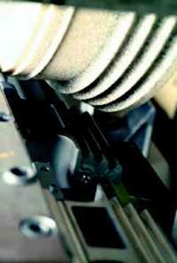

Creepfeed (CF) grinding offers an attractive alternative to other machining processes such as milling and broaching. But it also entails more variables. For an operation such as Abrasive-Form Inc., Bloomington, Ill., understanding the nuances of the process is key to exploiting CF's competitive advantages. It also helps to have the right machines in place on the shop floor.
In CF grinding, a formed grinding wheel plunges full-depth into the workpiece, producing a finished part in a single pass. This contrasts to surface grinding, where the grinding wheel rapidly reciprocates as it gradually lowers to the final depth-of-cut.
CF variables include machine rigidity, stability, and repeatability; wheel materials and performance; dressing systems; coolant types and application; fixturing; and gaging. Once these are managed, the process makes for fast cycle times, high repeatability, and close tolerances. In addition, the process easily handles superalloys and fully hardened materials, giving superior surface finishes with burr-free edges.
