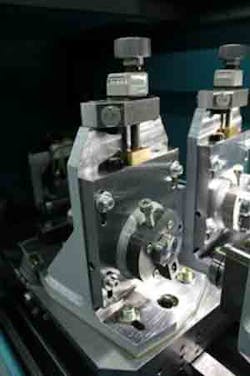

Deriving a highly flexible solution in this instance was challenging: The drilling device had to provide four degrees of freedom: 360° rotation of the workpiece around the middle axis, height adjustment, cross adjustment and angle adjustment for the inclined holes in horizontal direction. Cross and angle adjustment could be synchronous for both spindles.
However, the rotation and height adjustment for both workpieces had to be adjustable separately for each spindle.
“Our claim is to supply complete and 100% functioning solutions, consisting of deep hole drilling machines, drilling tools and all other machinery components,” explained TBT sales manager Andreas Schlegel. “Beside this, devices that may include components for automatized production. In this case, the customer decided against an automatized solution due to cost reasons and commissioned us to install a manual device.”
Frequently, the diameters of coolant holes in a tool shank differ. For drilling from both sides, the user embraces the workpiece. A stop ensures exact positioning. A clamping screw fixes the cylindrical shanks, which are equipped with a milled groove for this purpose. In the variant shown here, the drilled hole with d1 proceeds inclined and outside of the middle axis. In the mid of the workpiece, it meets the drill hole with d2, which also is eccentrically positioned but parallel to the middle axis.
The difficulty is that the slanted d1 drill hole must meet the d2 drill hole exactly at this position to prevent improper cross-sectional constriction.
Due to significant variance of drilling depths for different workpieces, the manufacturer uses the drill bush carrier in two ways: For depths up to approximately 200 mm, immersion sleeves are used to achieve the contacting movement of the drill bushes to the workpiece by using springs. For higher drilling depths, the user disassembles the immersion sleeves and uses a sealing case. In this case, there is also the possibility of installing a tool steady for the support of the deep hole drilling tools.
“Our solution includes a lot of ingenious details,” Schlegel said. “All deflections can be adjusted quite simply and with the sufficient precision in using either scales or digital displays.”
Since even small angle deflections will cause a large transverse offset in long workpieces, the available space in the ML200 was initially a topic of discussion. However, the engineers were able to combine all the requirements, quality, and available space. The customer didn’t have to invest in a larger machine - which was one of his main concerns. “And for all drilling processes, the standard safety guard can still be closed,” Andreas Schlegel added.
