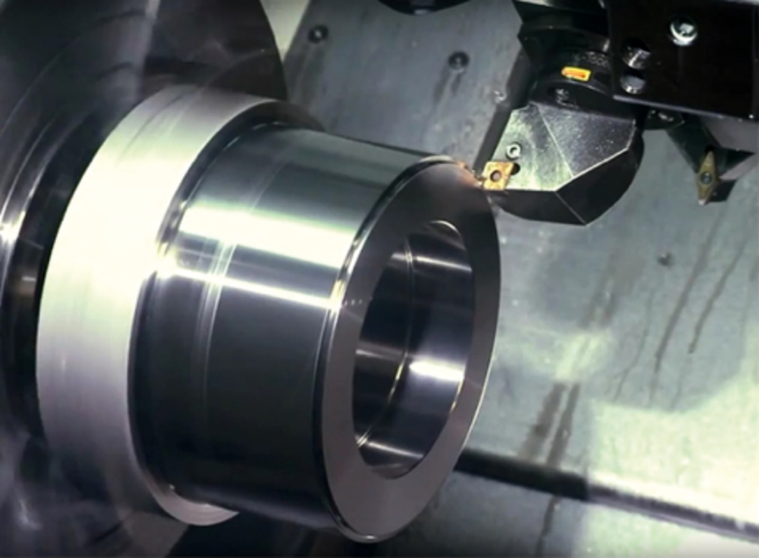

Advantages of specialty machining steels — The Sanmac range of steels has been designed to give improved and more efficient machining. Sanmac steels have already proven their value in service: operators have achieved new machining speeds up to up 240 m/min as a result of the material’s consistency, insert development and enhanced cutting data.
A specific material is Sandvik Sanmac 2205, a machinability-improved duplex (austenitic-ferritic) stainless steel. The chart and graph shown below describe the recommended inserts and cutting values (starting values) for the grade. It has characteristics that distinguish it from other, more conventional, materials, largely due to an adjusted balance of sulfur levels and the addition of non-metallic inclusions.
As a result, Sanmac steels are more machinable than conventional materials, but they do not sacrifice the original grade’s corrosion resistance or other valuable qualities.
Sandvik Sanmac 2205 can withstand demanding turning processes better than austenitic options due to its enhanced mechanical strength. Although turning with normal austenitic 300 series material grades might seem easier, such materials are prone to poor chip breaks, exhibit poorer surface quality, and cannot withstand higher turning speeds. These conventional grades also are more vulnerable to corrosion, less able to tolerate impact at low temperatures, and are less weldable due to changes in mechanical strength.
Material properties of Sanmac — An important differentiating factor between Sanmac steels and conventional grades is the correct balance of micro inclusions, non-metallic defects that significantly enhanced control of the shape, size, and hardness of the material. In turn, this ensure Sanmac has exceptional workability, as well as outstanding mechanical and corrosion-resistant properties.
Sanmac duplex stainless steels also have good impact strength, at room temperature and low temperatures. According to NORSOK standards, when subjected to impact testing at -46°C (-51°F) Sanmac 2205 greatly exceeded the required values. The material also shows high levels of resistance to general corrosion, pitting, and crevice corrosion.
Sanmac 2205 is very resistant to stress corrosion cracking (SCC) with a Pitting Resistance Equivalent number of >35. The higher the PRE number, the greater will be the resistance to pitting.
Eliminate machining with hollow bar — Further advantages may be achieved by machining with hollow bar, in particular time and cost savings. Machining with hollow bar can expedite the machining of components such as valves, flanges, coupling, seals, flow meters, and pump bodies, and their associated parts.  A notable advantage is that machining with hollow bar eliminates the need for a central bore, one of the most demanding machine operations, and use of hollow bar can eliminate some aspects this process entirely. The result is improved productivity and reduced costs: using Sanmac hollow bar has been shown to generate machine shop productivity gains of around 20%.
