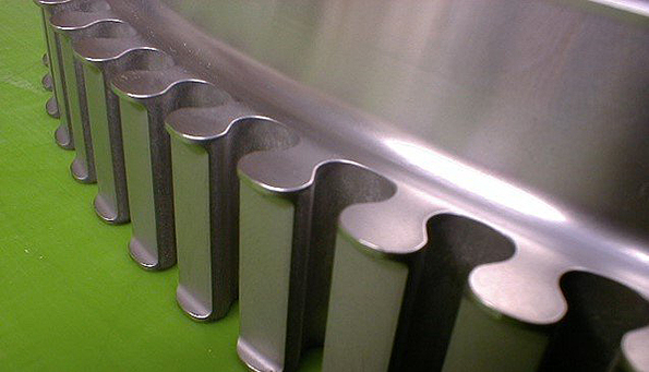

Vibratory finishing is a standard process involving tubs of various sizes that hold both the rough production pieces as well as non-abrasive materials or media: that media applies the abrasive treatment to the parts’ surfaces, which achieves the final finish. The vibratory action of the tubs continues for as long as necessary until the manufacturer achieves the desired result.
Grinding media plus vibratory action combine to deburr gears and achieve a desired surface quality.
