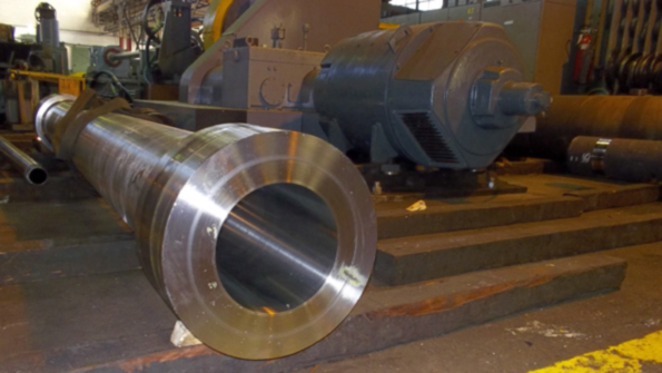

This 316 stainless steel cylinder is 144 in long with a bore size of 85 in and with a main section wall thickness of 15 in The part was finish bored honed and machined at American Hollow Boring Co with total indicator runout under 0010 in in the bore With the bore complete all other finished features were made according to the drawing

The part shown in the photo above is a 316 stainless steel cylinder, 144 in. long with a bore size of 8.5 in., and with a main section wall thickness of 1.5 in.  The part was finish-bored, honed, and machined at American Hollow Boring Co. with total indicator runout under 0.010 in. in the bore.  With the bore complete, all other finished features were made to the drawing.
