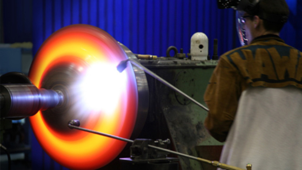

Metal spinning is a near-net shape forming process in which a disc of metal is revolved at controlled speeds using a specially designed machine. It functions like a lathe, though instead of a chuck to clamp the workpiece, a spinning mandrel is mounted to the machine to define the internal contour of a part to be produced. The round blank is clamped between the spinning mandrel and tailstock spindle; then the blank and mandrel are rotated together.
As the mandrel rotates, a spinning tool makes multiple passes over the blank, forcing it against the mandrel and causing the metal to flow mechanically, taking the shape of the internal form.
