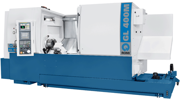

Induacutestrias Romi introduced two new turning centers this month at Brazilrsquos Feimafe 2013 exhibition The GL 400 turns parts up to 400 mm diameter and 1000 mm long

GL 400 turning center, for medium/high-volume production VTL 700MR vertical turning center, for versatility

The first of the new machines is the Romi GL 400 turning center, powered by a 30-hp motor and able to turn parts up to 400 mm diameter and 1,000 mm long. The GL turning center series was designed for medium- and high-volume production, with great efficiency and productivity.
