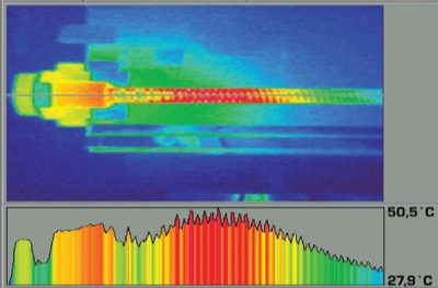

To increase rapid traverse velocity, either the pitch or the rotational speed of the ball screw must increase. In the last 5 years, the maximum permissible speed of such ball screws has doubled; however, due to the continually increasing requirement for acceleration, the preloading and therefore the friction of the ball nut could not be reduced. Ball screw drives, therefore, generate significantly more heat than before and will generate even more in the future.
According to Heidenhain research, if a feed drive ball nut has a typical preload of 3 kN (2212.7 ft/lbs.) and a missing wiper, the unit's no-load or frictional moment would be 0.5 to 1 Nm (0.369 ft/lbs. to 0.738 ft/lbs.). In rapid traverse at a ball screw speed of 2000 rpm, approximately 100W to 200W of frictional heat would be generated in the ball nut. Such an amount of heat is enough to cause expansion of the adjoining feed components, and with typical time constants of 1 to 2 hours, the positioning error due to thermal expansion can be in the magnitude of 0.1 mm, depending on the nature of the part program. This positioning error therefore outweighs the thermally induced structural deformation and geometric error of machining centers.

A suggested rule of thumb for thermal expansion is that, over the entire length of a cold ball screw 1 meter in length, the ball screw grows by approx. 0.5 to 1 µm after every double (back-and-forth) stroke. This expansion accumulates within the time constant. After every new part program, a feed drive system as just described would require approximately 1 hour to attain a thermally stable condition. This also applies for interruptions in machining.
