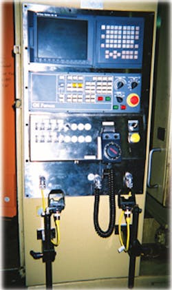

For its in-the-field gear-cutter or hobber retrofit, Drake quickly installs new, updated CNCs to get equipment back in production faster.
If needed during a retrofit, Drake upgrades a machine's electrical, non-CNC hardware and ties it into the new CNC.
New servomotors installed during a Drake retrofit deliver a high encoder count, so machines run tight-positioning control loops for improved accuracy.

During installation, a crew of Drake engineers replaces servomotors and servo-feedback cables, adds new or updates existing machine scales, and puts in a CNC package housed in either a roll-around cabinet or a framework attached to the machine's existing control panel.
Depending on the condition of the machine's electrical, non-CNC hardware, Drake may fully upgrade starter motors, fuse packages, and other related components. With the upgraded electrical system tied into the new CNC, the machine is ready for initial startup.
