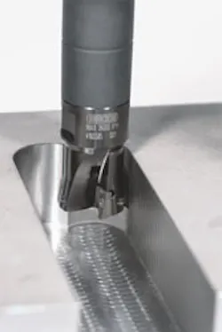

One good solution is trochoidal milling. In this process, the continuous rotation of the milling cutter is combined with a linear feed movement. Therefore, the required groove width is created with a high depth of cut in a slab milling process. Shell endmills with inserts and cylindrical carbide milling cutters are used along with other tools, where the tool diameter is smaller than the groove width being created. The low radial infeed leads to a clear reduction in the tool and machine bearing load. By then increasing the cutting speed and federate, machining becomes more economical than with conventional groove milling.
Trochoidal milling and plunge milling, along with rigid holders and newly available milling tools make it possible for low-end machines to achieve considerable chip volume with no loss of speed and performance.
Also, in conventional milling, where one material layer is always removed on every pass, radial forces are mainly applied to the spindle. In the cases of high projection lengths and high shear forces especially, this result in considerable bending motions. If large volumes of material are being removed from thin-walled workpieces, the feedrate and cutting speeds must necessarily be reduced to avoid excessive vibration.
In these cases, plunge milling can be a smart alternative. In this process, machining does not occur at the perimeter of the tool but on the front side instead. Machining is achieved by the offset plunging of the tool. The load is applied vertically on the spindle and workpiece clamping, that is, only in the directions of the greatest machine rigidity. As a result, higher cutting values are achievable, even on lighter machines.
