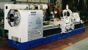

The Broadbent PA45X3M has a 12-in. spindle bore, with 90° hydraulic copying with auto nut retraction and semi-automatic cycle.
