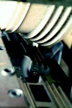

Creepfeed grinding produces parts in a single pass, making it an attractive alternative to milling or broaching.
A turbine airfoil CF ground by Abrasive-Form.
These tiny terminal chips were CF ground from an aerospace alloy in batches of 120,000. Part dimensions are 0.098 0.062 in.
Creepfeed (CF) grinding offers an attractive alternative to other machining processes such as milling and broaching. But it also entails more variables. For an operation such as Abrasive-Form Inc., Bloomington, Ill., understanding the nuances of the process is key to exploiting CF's competitive advantages. It also helps to have the right machines in place on the shop floor.
In CF grinding, a formed grinding wheel plunges full-depth into the workpiece, producing a finished part in a single pass. This contrasts to surface grinding, where the grinding wheel rapidly reciprocates as it gradually lowers to the final depth-of-cut.
CF variables include machine rigidity, stability, and repeatability; wheel materials and performance; dressing systems; coolant types and application; fixturing; and gaging. Once these are managed, the process makes for fast cycle times, high repeatability, and close tolerances. In addition, the process easily handles superalloys and fully hardened materials, giving superior surface finishes with burr-free edges.
Abrasive-Form CF-grinds aluminum, cold-rolled steel, high-nickel alloys, hardened materials, carbide, tool steels, and ceramics, with volumes from a single part/day up to 50,000/day. Applications include aerospace engine components, landbased turbines, automotive engine and drivetrain components, tiny medical parts, and parts for the military.
"There's very little we can't do," says Ken Kummer, Abrasive-Form CEO, "including slots for hydraulic van pumps and aerospace turbine blades — jobs in difficult-to-grind materials and with close tolerances. We do linear operations of all sorts as well as contours. We can do 3D grinding and have machines with up to 5-axis control. With a combination of CBN and diamond wheels, plus continuous dressing, we have a lot in our arsenal."
Typical tolerances run ±0.0005 or ±0.0002 in., with CpKs of 1.33.
