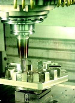

Longer tool life is importantforanumberof reasons, including cost savings for regrindings and replacements. For example: To take full advantage of its 5-axis machining centers, Oberg Industries, Freeport, Pa., a precision manufacturer, switched from high-speed steel tooling to high performance carbide tools with engineered microgeometry process edge preparation supplied by Seim Tool of Latrobe, Pa.
"With engineered micro-geometry process edge prep, the interval between sharpening typically is extended by about 300 percent, which is a great return on investment for the engineered micro-geometry process. Longer intervals between tool replacement also mean less interruption to production and lower labor costs," says Bob Binner, toolroom manager at Oberg.
More importantly, according to Binner, are the indirect cost savings: "The edge prep practically eliminates tool breakage, which can cause a train wreck in our automated processes. Tool breakage in an unattended machine results in a domino effect that can cause other tools to break downstream. Such failures can be very expensive in terms of tool damage and loss of expensive parts, and subsequent problems can be difficult to correct. With carbide tools having engineered micro-geometry process edge prep, we have been able to operate our high-speed process with confidence, sometimes going weeks without replacing drill bits and reamers."
