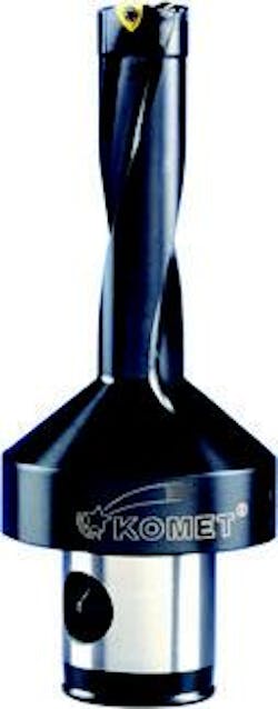

European machinists use techniques that combine minimal amounts of coolant with shop air to reduce the large volumes of coolant typically needed for drilling, Herman notes. ChipBlaster, Seco-Carboloy and Komet of America Inc. (www.komet.com) all recommend that coolant feed pressures be kept high, and Herman and Sundstrom say very high pressures only add to coolant's effectiveness. Also, all three companies recommend that machinists use through-thetool coolant technology for holemaking, but that is not always possible.
Through-the-tool coolant technology has a limit. As holes approach sizes of 0.1969 in. (5 mm) and smaller, coolant cannot always be supplied through the bit, and external coolant techniques must be used. While some square-type and g-type drills provide through-the-tool coolant technology for drills smaller than 0.1969 in., pecking techniques usually are required to drill holes that small.
In pecking at a hole, the machinist advances the drill to one or two times its diameter, clears the hole and flushes it with external coolant to remove chips. While pecking may be time consuming, it is better than the alternative, says Mike Herman, director of distributor sales for Komet of America. "If you break a drill that small in a hole, you might need a wire EDM to get the drill out, or you might be facing scrapping a workpiece worth thousands of dollars," he said.
