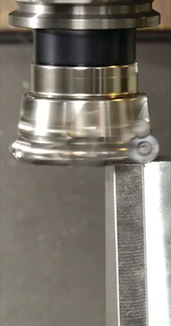

Advance Machining & Gear ran eight wedges at a time on a 4-axis Matsuura horizontal CNC mill using a 2-in., zero-rake milling cutter. The shop used a solid-cobalt twist drill for holemaking. Cycle time to mill and drill each batch was 182 min running the milling cutter at 700 rpm and feeding at 40 ipm. After retooling with an Ingersoll 1-in. IC Form-Master button cutter and replaceable-tip Qwik-Twist drill, the shop slashed cycle time to less than 79 min. That is less than half the previous cycle, and it saved more than $10 per part. The shop cut $15,000 in costs from the job that is now repeating at 600 pieces per month.
The majority of Advance Machining & Gear's chipmaking involves rough milling steel and cast iron. Dunaway says the company saves the most — $75,000 per year — by cutting cycle times for these operations. The shop has standardized its milling operations to run at 100 ipm and 1,500 sfm and, depending on workpiece and cut geometries, it uses either an Ingersoll V Max, Form-Master or Hi Pos milling cutter, all of which remove material twice as fast as any cutters the shop previously ran.
