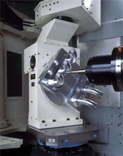

Makino’s 5-axis machining center.
Many shops realize that five-axis machining is a quick way to machine multiple part sides in one clamping to reduce setup times and shorten lead times. But what they may not know is that full, simultaneous five-axis machining is not always the most accurate way to cut parts. Instead, five-axis positioning, or what is known as 2+3 machining, can add up to more precise machining operations.
While all a machine’s axes move simultaneously for full five-axis cutting, only three axes -– X,Y, and Z -– move for 2+3 machining. The other two rotary, or secondary, axes are used only for positioning. Once a part is oriented to allow the use of standard three-axis machining movements, the secondary axes are locked in place and do not move during the cut. A good 2+3 machining example is cutting an angled surface after it has been positioned as a flat surface.
Bill Howard, VMC product manager for Makino (www.makino.com), said a five-axis machine’s secondary axes are inherently less accurate, while its three main axes are more precise for positioning and repeatability. That is the reason that he believes 2+3 machining lets shops, especially those doing die/mold work, take full advantage of the precision built into a five-axis machine tool.
“It is the highest potential for precision because the two least accurate axes are positioned and locked in place, while the machine’s three other, more accurate axes do the machining,” Howard said. Other benefits of 2+3 machining include optimized tool contact with machined surfaces, minimized setups, increased quality, and faster throughput.
2+3 machining positions workpieces for making standard 3-axis cuts (top), while in full 5-axis cutting (bottom), cutters work their way down the angled surface.
