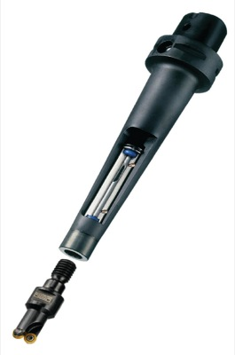

For example, inside Sandvik Coromant's (www.coromant.sandvik.com/us) Coromant Capto damped milling adaptor, a heavy tuning bar is suspended on rubber bushings and surrounded by a proprietary oil. When variations in cutting force cause the tuning bar to vibrate, the dampening system is activated, and the movement energy of the bar is absorbed into the tuning system.
