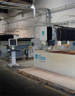

They are fitted with armor plating to protect their occupants. The armor plating is made of Kevlar, some of which is hybridized with S-glass, mounted to ballistic-grade aluminum or to hard steel armor plate. ArmorStruxx produces custom armor panels for these vehicles with waterjet systems from Flow International (www.flowcorp.com).
When fabricating the armor panels, ArmorStruxx produces the Kevlar armor material on site and cuts the composite material to size from 5-ft. by 10-ft. master panels. It also cuts mounting holes for various armor panels that are installed on the vehicles.
The shop does this fabrication on its seven IFB waterjet machines that have 87,000-psi cutting and use Dynamic Waterjet technology, and on one IFB machine that has 60,000-psi cutting.
All ArmorStruxx’s Flow waterjets run three shifts per day, seven days a week, and at the peak of its production ramp last month, the shop was shipping 35 vehicle sets per day to support two different MRAP vehicle platforms.
