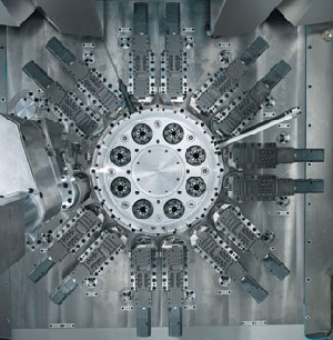

The MS22C-8 has eight spindles arranged in a spindle drum, with each one assigned two cross-slides that can travel both on the X as well as on the Z-axis. Each cross-slide can be additionally equipped with a Y-axis.

Each of the eight spindles, arranged in the well-known Index spindle drum, are assigned two cross-slides that can travel both on the X as well as on the Z-axis. Each cross-slide can be additionally equipped with a Y-axis.

Combined with a total of up to 16 cross-slides, the new eight-spindle machine is a true multitasker, even for highly complex machining operations. The speed of each of the eight liquid-cooled spindles can be controlled separately. The fluid-cooled spindle drum keeps the thermal growth in the spindle carrier to a minimum. The advantage over the previous air-cooling approach is the higher power density in the spindle drum and the ability to recover energy from the heated cooling fluid. In addition, the spindle bearing temperature can be kept at a low level, which also prolongs its service life and improves thermal stability.
The cross slides with integrated drive have a low-mass design with hydrostatic bearing support. Their low moment of inertia and resulting high dynamics make it possible to achieve exceptional acceleration in operation.
