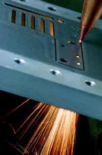

Cutting thin sheetmetal is the specialty of the Haas Z4-500 lasercutting system.
The 4th-axis capability of the Haas Z4-500 laser-cutting system enables precision radial machining of parts, including thin-walled tubing.
The Z4-500 Laser Cutting System from Haas Automation incorporates a compact sealed CO2 laser and lets Laser Cutting Corp. cut, drill, engrave, and weld thin sheetmetal quickly and efficiently.
