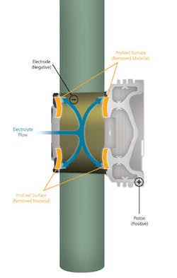

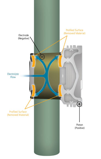

A cross-sectional diagram shows the HPEEM process, with the electrode positioned in the pinhole of a Monosteel piston. The electrolyte flow path and profiled surface are highlighted in orange.
Electro-chemical machining is a "reverse electro-plating" process: rather than adding a layer of metal to a surface, it erodes away a layer.
HPEEM process is very highly controlled electro-erosion method that removes an exact amount of material, precisely shaping the piston pinhole, and thus improving the load transfer capability and reliability of the piston. Having been developed at Federal-Mogul's advanced manufacturing technology development facility in Ann Arbor, Mich., HPEEM is in commercial operation at the company’s piston plant in Puebla, Mexico.
At Puebla, HPEEM produces Monosteel® pistons by machining very precise, accurate, and profiled pinholes that allow the piston to be assembled to a connecting rod without a bushing. The result is a pinhole form machined to extraordinarily tight tolerances, ensuring a design that is affordable and reliable for the OEM. Importantly, it means that the piston can achieve increased cylinder pressure while maintaining robust performance and durability — which lowers engine emissions.
Producing these components by a traditional method would involve a machining center that would be expensive to design, install, and operate, because it would have to be capable of moving a cutting tool precisely through the pinhole, to profile it to the required shape.
HPEEM uses a non-contacting, specially shaped electrode that is positioned precisely in the pinhole. With proper control of the voltage and electrolyte, the electrode uses electro-chemical machining to erode the steel surface of the piston pinhole.
For the Monosteel pinholes, HPEEM has the electrolyte flow between the electrodes and the pinhole surface. Controlled voltage is applied between the part and electrode to erode the material from the pinhole surface. The electrolyte flow washes away the removed material as it exits the piston cavity. With proper control, a profile is machined in the pinhole to a tolerance of a few microns.
