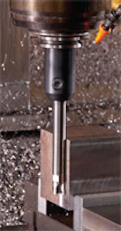

Ingersoll DHU plunge cutter delivers pure axial cutting forces for faster machining with no lateral forces that can cause tool failure or uneven results due to tool deflection.
When end milling long pockets, cutting forces can cause deflections along the tool’s X and Y axes resulting in workpiece dimensional variations. These forces can lead to tool breakage. On the other hand, with plunge milling, the cutting force vector runs straight up the tool centerline, so you can cut with more force without fear of bending or snapping the tool.
Plunge milling works much like drilling: plunge straight in, withdraw, step over plunge again, and so on. Since all the cutting force vectors are right up the tool’s strong centerline, you can safely feed faster by plunging along the Z axis than by end-milling along the X and Y axes. Plunging leaves a scalloped wall that may require finish milling, depending on tolerances and size of the stepover. Plunge cutters also have built-in chip evacuation capacity, so blast air or liquid coolant is helpful but not required on vertical setups.

The Ingersoll DHU plunge cutter features positive-positive geometry for on-track cutting and square inserts with back relief to avoid rubbing sidewalls behind the cutting face. The 0.75- in.-diameter end mill head is equipped with the Top On modular adaptation that connects with various steel and carbide toolholders. It is also designed for through-the-tool coolant delivery.

Ingersoll’s Derek Delucca and Kevin Dees established cutting parameters. Since ATM’s vertical machining center lacked through-spindle coolant capability for chip evacuation, they recommended running the cutter at 1,735 rpm, 17 ipm, with a surprisingly small 0.050- to 0.060-in. stepover and air blast for chip removal.
“While the small stepover would slow the hogging removal rate a little,” said DeLucca, “the resulting scalloped peaks would be small enough to meet tolerances without subsequent operations and attendant tool changes.” At 0.060-in. stepover, a 0.75-in. cutter leaves scallop ridges just 0.002-in. high, well within tolerances for the part.
Kollars loaded the DHU and, following DeLucca’s and Dees’s recommendations, modified the program in ATM’s G81 software. “It worked like a charm beginning with the first part,” Kollars said. “Machining time for the pair of slots dropped from 40 to 30 hours, all touch-up machining was eliminated and the insert edges looked as good as new after finishing both slots. And we’re completing the slots with the single tool and single setup.” On that basis, ATM projects a significant dollar saving per part.
