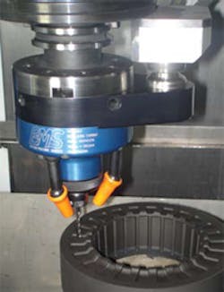

A variable-speed VRT spindle machines an EDM electrode at 30,000 rpm. Multi-tasking functionality, as of late, has become quite the mantra for machine tool developers. These types of machines can potentially deliver ...
