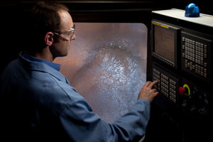

Andy Trimmer, a chemical engineer at the GE Global Research Process Systems Lab operates the Blue Arc thermal machining system that cuts engineering alloys faster and with less energy than conventional milling.

“In addition to saving time, Blue Arc saves electricity,” Trimmer continued. “BlueArc requires lower force to achieve high material removal rates compared to conventional machining. Since the equipment does not need to be as heavy-duty to withstand the machining forces, the motors used to drive the axes are smaller and use less energy. Being able to save time and tooling costs is one thing. But when you also can reduce plant energy usage, this achieves the trifecta of best-in-class manufacturing.”
BlueArc is an electrical discharge machining process adapted to “hog out” large volumes of material. Typically, aerospace alloys are difficult to machine and have material properties that are similar to the cutting tool’s properties, which shortens cutting tool life significantly. In conventional milling, the tool must have a higher hardness than the workpiece material so chips can be produced. As material properties approach that of the cutting tool, milling has to slow down to preserve tool life and prevent breakage, and this increases production cost.
Because the material removal mechanism is electro-thermal rather than mechanical, the process is not affected by the material properties of the workpiece. This means low-cost electrodes can be used rather than carbide tools. The material is submerged to help cool it and shield the arc discharge. High-pressure flushing is used to evacuate chips from the cutting zone.
GE’s Blue Arc thermal cutting process has been adopted by GE Aviation as a roughing step in the manufacturing of blisks for its commercial aircraft engines. In a subsequent step, the thermal artifacts are removed by conventional machining.

Mike Lamphere, a senior manufacturing engineer at GE Aviation in Hooksett, N.H., demonstrates the patented Blue Arc thermal machining process.
