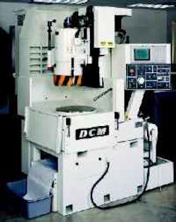

The PDG Punch and Die Grinder, the IG 180 M, and the IG 280 CNC, all from DCM Tech. Inc., showcase the latest machine innovations for vertical-spindle rotary-table surface grinding.
A PDG vertical-spindle rotary-table surface grinder at Metcam replaced a manual surface grinder for sharpening the shop's punches and dies.
Advent Tool and Manufacturing's IG 280 CNC grinder sports a Mitsubishi C-5 programmable CNC.
A DCM IG 180 M grinder meets Elna Magnetics' demands of finish, accuracy, flatness, and parallelism for ferrite parts.
