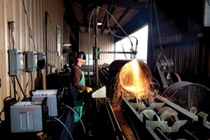

Hypertherm engineers replaced a one-piece mechanized barrel with a modular design that converts easily and quickly from a long torch to a short one. Users work with the standard 15-inch torch or remove a section from the barrel to create a 6-inch mini torch, better suited for robotic applications, pipe saddles, track burners, and other applications where the extra barrel length is problematic.

During their visits to torch users, the Hypertherm engineers noticed that the standard length mechanized torch was often cumbersome for pipe cutting and robotic applications. Their solution was to replace the one-piece mechanized barrel with a modular design that could easily and quickly convert from a long torch to a short one. Users could either work with the standard 15-inch torch or remove a section from the barrel to create a 6-inch mini torch, better suited for robotic applications, pipe saddles, track burners, and other applications where the extra barrel length was a problem.
