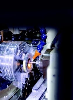

Setting up for I.D. grinding jobs is different from setting up external and surface grinding operations. Because of the wheel-within-a-hole configuration of I.D. grinding, shops must pay special attention to the area of contact between the wheel and workpiece and, most importantly, to the relationships between wheel speed, workpiece speed, rigidity of the wheel spindle and other operating factors.
Most shops believe that selecting the proper I.D. grinding wheel for a particular job involves nothing more than knowledge of the material to be ground. However, in most cases they are wrong, says Bill Bednarski, an application engineer at Saint-Gobain Abrasives (www.nortonabrasives.com).
Consider a shop that does a lot of O.D. cylindrical grinding using 32A aluminum oxide wheels (a strong sharp monocrystalline grain) on hardened tool steels, then uses the same wheel specifications for its I.D. grinding operations. The result can be that the shop sees problems with chatter and grinding burns. In addition, to make the wheel perform properly, operators must dress it several times per part. On the other hand, if this shop used a 25A wheel (a more friable grain in J grade — two grades softer) for the I.D. grinding operation, that chatter and burning would be eliminated and dressing cycles would be put back to once per part.
But Bednarski said there are several other factors, besides the material to be ground and its hardness, that shops must consider when choosing the grain and grade for a grinding wheel for "inside" work. These factors include the amount of stock that is to be removed, grinding accuracy and surface finish, area of contact, wheel size, workpiece speed, wheel speed and operating factors and grinding system rigidity.
