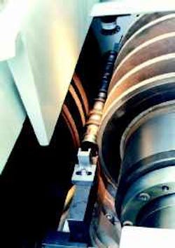

A high-speed centerless grinder equipped with CBN wheels boosts productivity in an application involving camshaft bearing seats.

Centerless plunge-cut grinders are particularly well-suited to high-volume, long-run production — especially when teamed with crystalline-boron-nitride (CBN) wheels. In fact, these machines are built to use CBN, employing features such as Granitan machine beds, which absorb vibration and maintain thermal stability, and stiff grinding spindles, mounted in bearings at both ends, that deliver peripheral speeds to 120 m/sec. Lubricant mist, which forms at these high speeds, can be extracted under vacuum and separated from the working enclosure.
Buying sets of CBN wheels can quickly add up, but this cost is often justified by their durability and productivity. For instance, it's not unusual for a set of wheels to process over 500,000 camshafts. Compared to conventional abrasives, CBN lowers the costs of grinding wheels per workpiece and prolongs the service life of regulating wheels thanks to a reduction in grinding forces.
In an example involving bearing seats for cast-steel camshafts, a centerless external-cylindrical grinder rough grinds five bearing seats to the specified machining allowance of 4.1 mm in 12 sec. This level of efficiency eliminates the need for preliminary turning.
In the case of finish grinding, fine tolerances must be achieved for diameter and roundness and low degrees of roughness; therefore, it's a good idea to use centerless-cylindrical grinding with CBN wheels that have coatings in a ceramic bonding, which can be re-profiled. The advantage is that these wheels are profiled when mounted and can be made to run true. In use, particularly at high speeds, they deliver high throughput and surface quality. Also, profile wear and changes in roundness take place more slowly than with conventional grinding wheels and are counterbalanced by the longer intervals between dressing operations.
