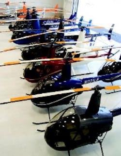

A Company With Lift
Helicopter Co.'s first mailing address was company founder Frank Robinson's home where he designed the R22-model helicopter in 1973. He built the prototype for the aircraft in a small tin hangar at the Torrance Airport and first flew it in 1975.
In 1979, the company delivered the first production R22, which soon became one of the world's top selling helicopters for civil uses. Since its introduction, the R22 won and continues to hold major performance records for its weight class, including speed and altitude. By the mid-1980s, Robinson Helicopter was building its R44 model and, to date, the company has shipped 6,500 helicopters worldwide.
The company machines, assembles and paints its helicopters in a 480,000-sq-ft facility that houses about 1,200 employees. It operates approximately 69 CNC machines, including machining centers, lathes, mills, waterjet-cutting systems, lasers, EDMs and the Studer universal cylindrical grinders.
