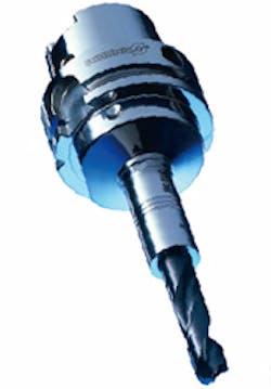

Single-unit constructed toolholder
Collet chuck toolholders
Internal workings of a hydraulic toolholder
Heatshrink toolholder

As an alternative to the costly hydraulic or heatshrink-type toolholders, a one-piece or single-unit constructed, toolholder could be the correct choice. One-piece toolholders have accuracy, balance and torque capacities that lie between hydraulic and heatshrink-type holders, and are less costly. These toolholders include one-piece systems that have special, non-round I.D. holes that rely on the spring tension in the steel of the holder itself to secure cutting tools. They work in a way that is similar to heatshrink toolholders, but without the need to heat them: shops place the holder in a compressing unit that squeezes the non-round I.D. hole to a round shape, load the tool, and release the pressure. The holder constricts around the tool shank to hold the tool in place.
