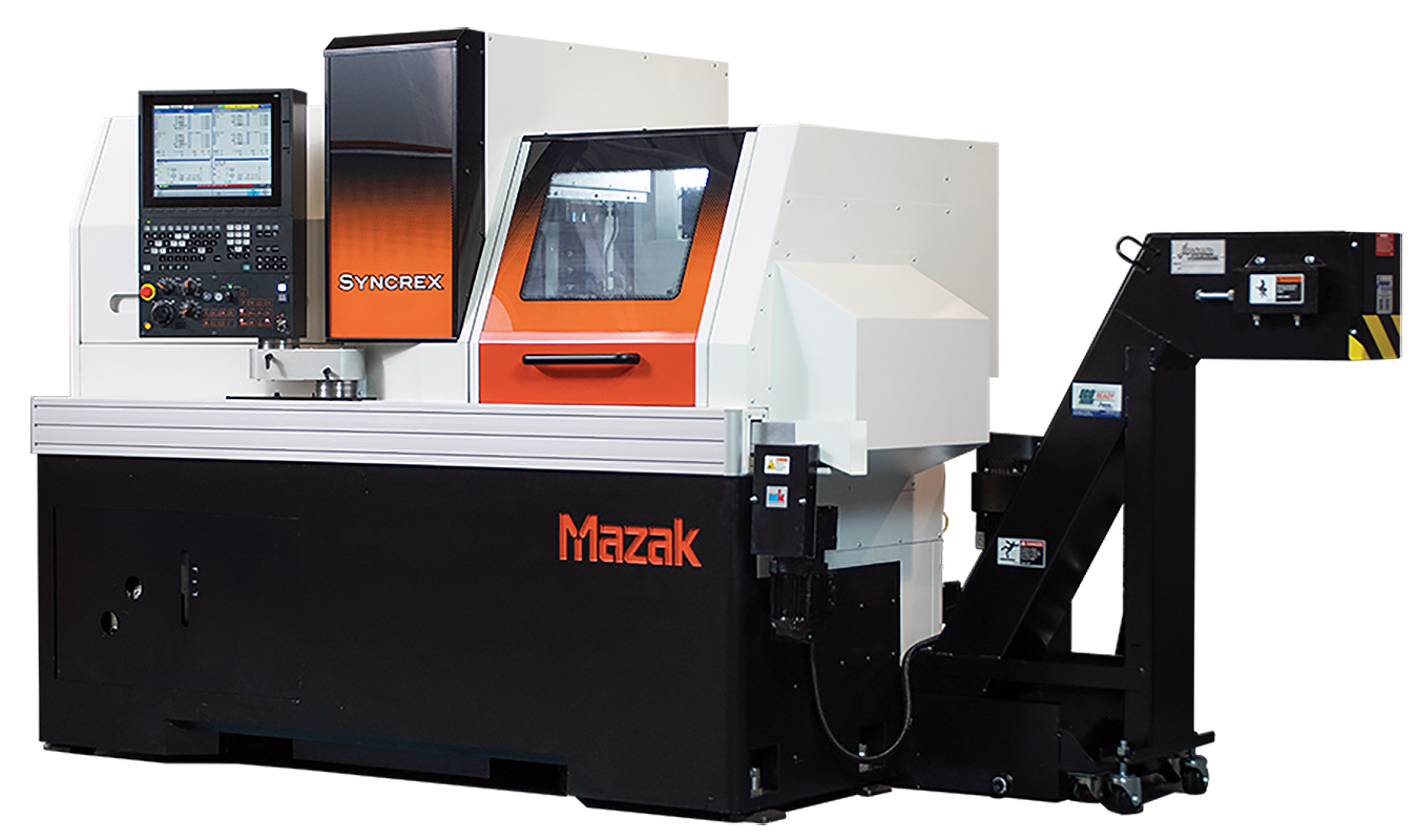

The sliding-headstock SYNCREX machines are offered in four bar-stock capacities (20 / 25 / 32 / 38 mm) and four different axis configurations, up to a 9X model with full B-axis contouring capabilities.
Swiss machines produce high-volume precision parts typified by a high length-to-diameter ratio: the machines are configured to feed stock through a guide bushing, so that the OD turning tool cuts the stock near to the bushing where the material is supported – and thus longer workpieces can be produced with precision.
All the SYNCREX machines are built on Mazak High Damping Composite Castings (HDCC), produced in the U.S. and machined by Mazak. According to Mazak, the high-rigidity base “provides greater vibration damping characteristics, less thermal growth, and greater part surface capabilities” than a cast iron base machine.
Mazak also produces SYNCREX spindles, headstocks, sheet metal, and numerous other components in Kentucky, which contributed to accuracy and repeatability.
The SYNCREX plant has a capacity of 10 machines per month. Production flow through the building starts with a machined base that progresses through assembly operations and on to alignment, testing, inspection, and runoff procedures, prior to shipment.
