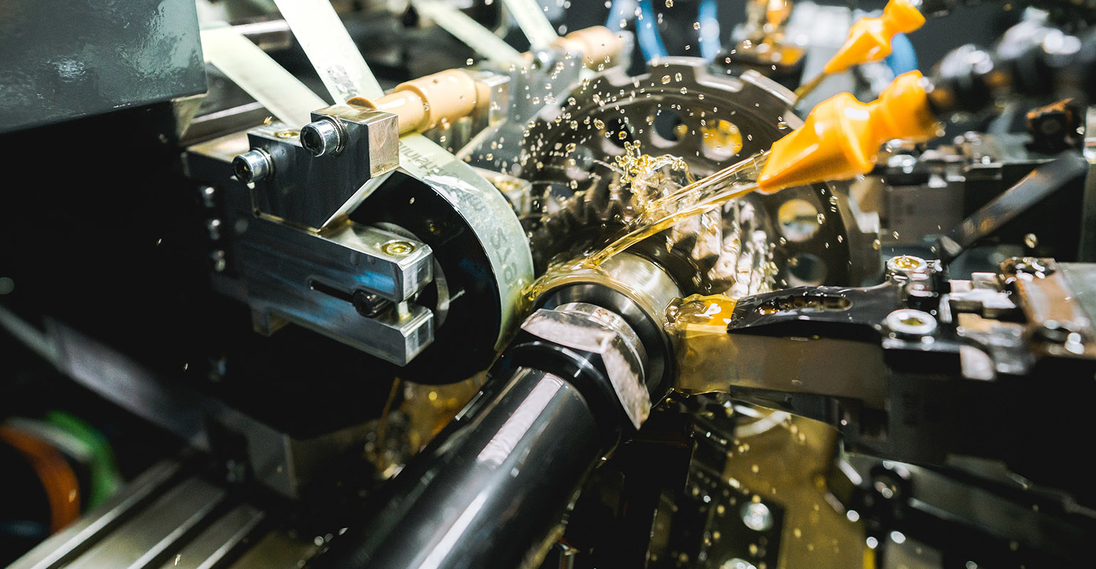

ZF uses the NaShaft Eco 612 to process various transmission shafts with overall lengths from 150 to 380 mm, with bearing journals in the range of 30 to 60 mm diameter. Tension is applied between centers.
After grinding, the values for cylinder shape and surface finish are around 8 µm and Rz 2.5 µm. The targets for superfinishing are <5 µm and Rz <0.7 µm. Nagel developed a hybrid process for this task.
"There is a stone process and a tape process,” Christian Feuchter explained. “The stone process ensures an improvement of the waviness on the bearing journals, it therefore optimizes the cylinder shape or the shape accuracy. The subsequent tape process improves the surface quality."
The NaShaft Eco finishing center is equipped with four finishing modules. The shafts to be machined have two bearing locations. Consequently, both bearing journals can be machined simultaneously, first in the stone process, then in the tape process. The pure machining time for one shaft is 15 seconds.
