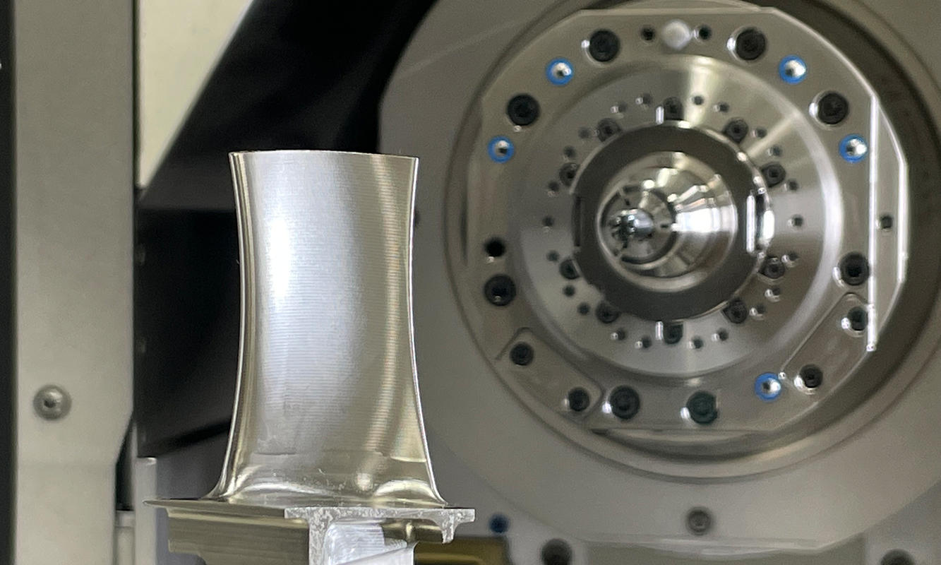

Part of meeting those challenges is having the best possible equipment in their shop. Recently, SixDigma added a GROB G350 universal machine to expand its machining capabilities, and thanks to the machine’s high precision and effective design, SixDigma has seen an improvement in machining tolerances and efficiency.

Gasparraj noted the GROB G350’s compact machine exterior compared with the large machinable volume – and the large part sizes made possible by the machine’s unique working envelope. More than that, the compact size compared with large machinable volume adds the stability that SixDigma needs for the demands of aerospace applications.
GROB’s kinematic arrangement puts fixed-frame components close to the machining envelope, such that even the most extended tool position is never more than a foot away from the fixed frame – which provides stability for both the part and the cutting tool.
“Our experience with our new GROB G350 proves that it’s one of the most stable machines we’ve ever come across,” Gasparraj added. “Given the increased force placed on the machine by the hard aircraft materials we use, the stability of the machining action is critically important.”
The G350’s high stability also translates into greater production efficiency for SixDigma. Because the GROB universal machine can deliver tolerances up to 10x more precise than even the highest precision required by SixDigma’s customers, repeat work is almost never necessary.
“In our adaptive machining solutions, we’re chasing tolerances that are some of the smallest in the industry at about +/-10/1000th of an inch,” Gasparraj said. “With the G350’s ability to maintain tolerances down to 1/1000th of an inch in most cases, accurately and repeatedly, we’re able to overdeliver on part quality to even the most demanding aircraft customers.”
