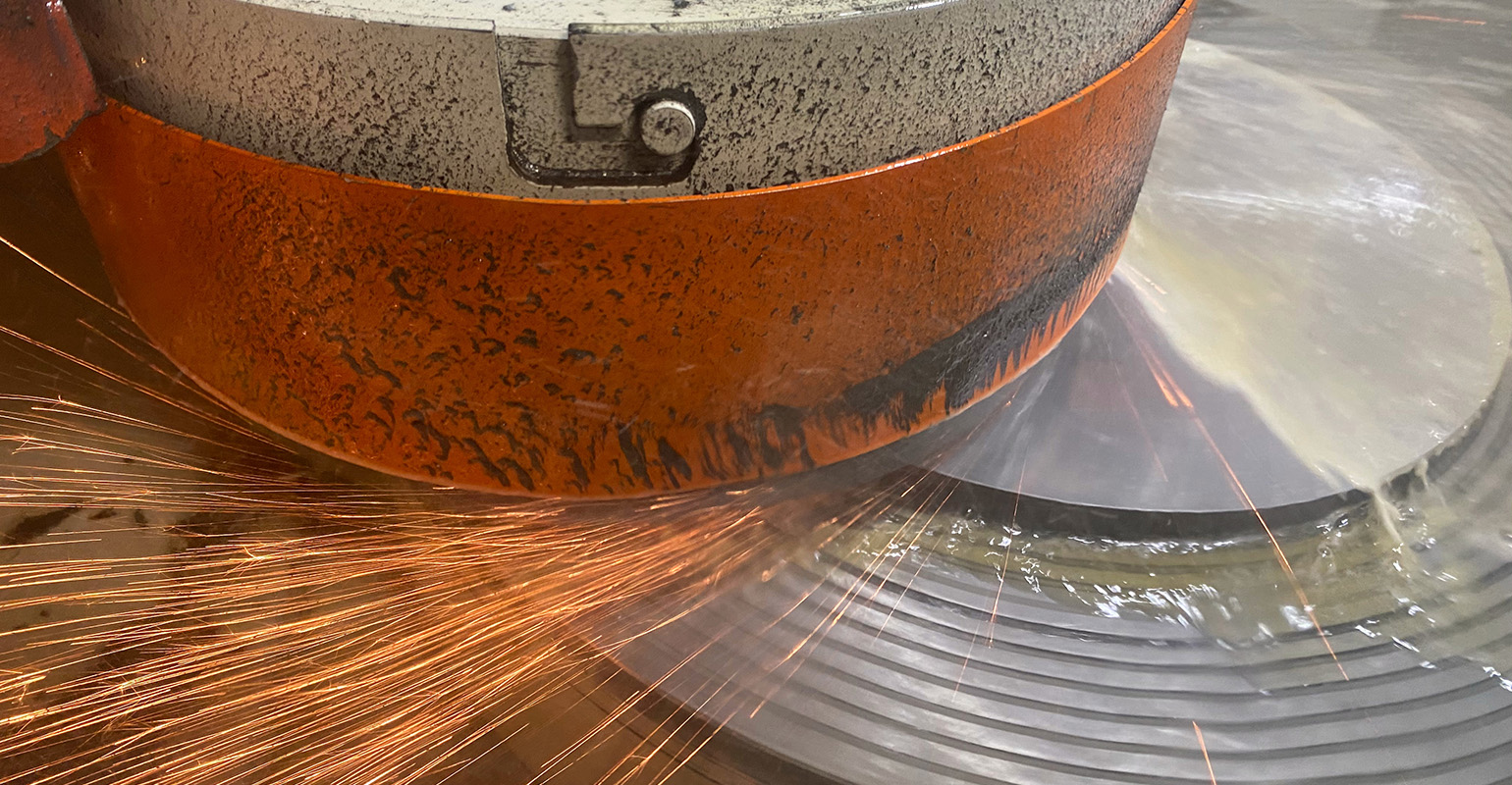

Automated rotary surface grinders – With a modern vertical-spindle, rotary-table surface grinder, the table rotates with the workpiece held firmly in place underneath a vertical spindle. The grinding is not performed by the peripheral edge of the wheel, but by the entire diameter of the abrasive surface, which facilitates grinding performance and consistency.
“With rotary-table surface grinders, the entire part passes through the wheel, which is more efficient than reciprocating table grinders that may have workpieces wider than the grinding wheel,” said Lawson.
Today, surface grinders are designed with much more advanced sensors and controls that automatically maintain very tight tolerances, removing material down to within one ten-thousandth of an inch of the final thickness. Digital technology allows for an interface with easy-to-use touchscreen controls. When combined with automation, surface grinder operators no longer are required to be highly trained individuals.
For example, rotary units such as DCM Tech’s IG 280 SD, with a 24-in. variable-speed table and 20-HP variable-speed grinding spindle motor, make it possible for virtually anyone to operate a unit successfully. One example of innovation available in this model involves automation of the initial contact between the abrasive wheel and the part, which typically had to be finessed by the operator. With this updated option, advanced sensor technology detects vibration and can automatically fine-tune not only the pressure of the spindle motor but how quickly it moves the wheel down onto the part. When the machine senses the abrasive wheel has contacted the part, it automatically begins the grind cycle.
“Automatic part detection eliminates the need for the operator to do time-consuming, error-prone ‘manual touch offs’ where they would manually feed the [grinding] machine until it just touches the surface of the part before backing off and restarting it,” according to Lawson.
