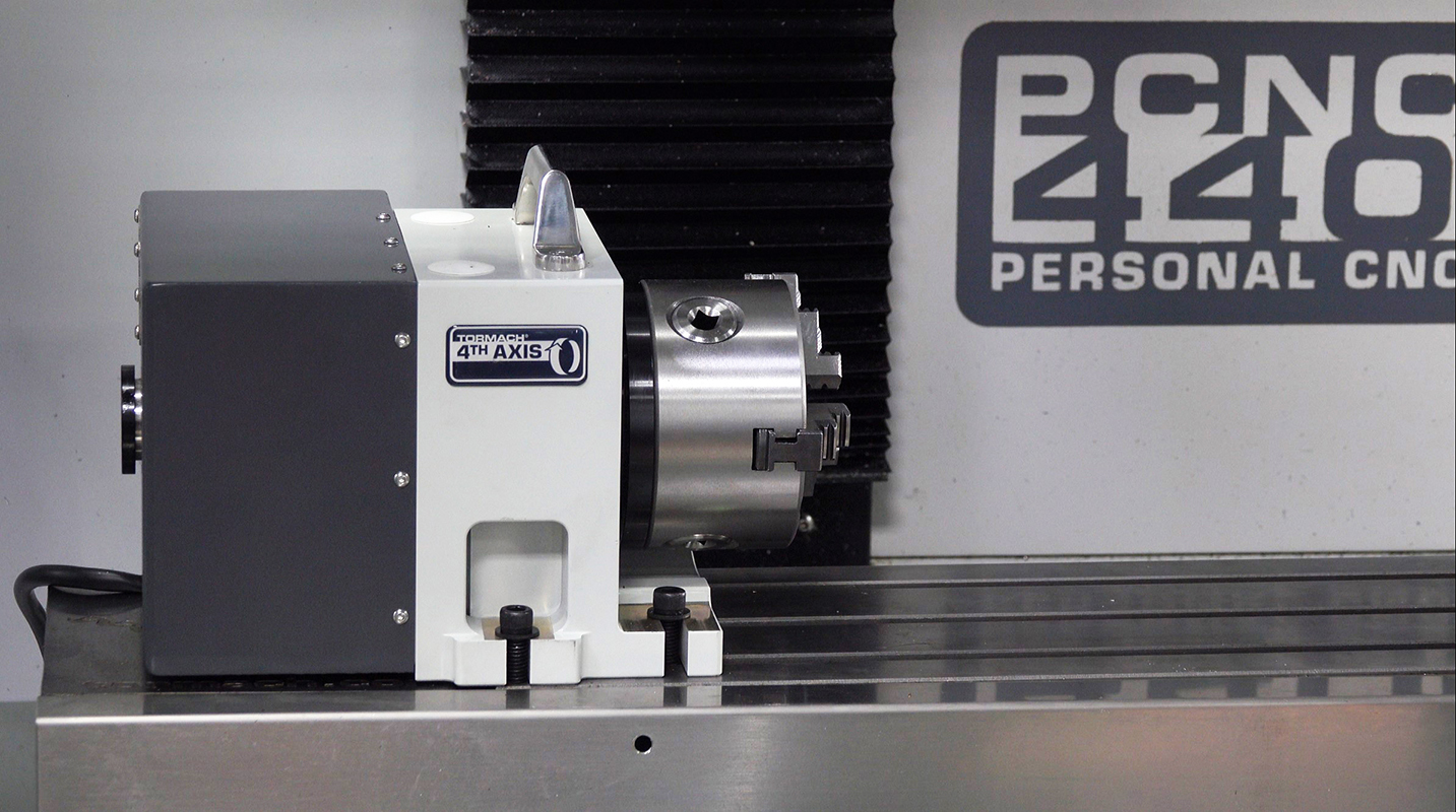

TORMACH INC. is offering the microARC 4, a device that allows high-precision fourth-axis machining in a compact footprint.  The microARC 4 works with all Tormach machines, from the PCNC 440 Mill to the 1100 M/MX Mill, and it is available at an affordable price.
microARC 4 reduces both operator workload and cycle times with a high-quality, low-maintenance harmonic drive.  The drive provides extremely precise motion control, coupled with much higher rapid speeds than a worm-drive unit.
The main features of the microARC 4 include:
- Near-zero backlash levels because of the harmonic drive system; compared to a similar size worm-drive fourth-axis unit, the microARC 4 achieves anywhere from a 400%-600% reduction in backlash;
- No maintenance required, providing a much lower cost of ownership than an oil-filled worm drive unit, which requires periodic oil changes and top-ups;
- Smoother start and stop motion due to a crossed-roller bearing instead of a large oil-film hydrodynamic bearing that is common on most other fourth-axis units, which require a transition from static to dynamic friction;
- 19-mm center bore pass-through for long bar stock; stock can be passed all the way through the chuck and out the back of the fourth axis – no need to cut stock into small pieces when doing a production run of many parts;
- The microARC 4’s motor is mounted directly in-line with the axis of rotation instead of off to the side, providing an extremely compact footprint;
-Lightweight and strong aluminum body allows for installation into the machine without a hoist or team lift.
