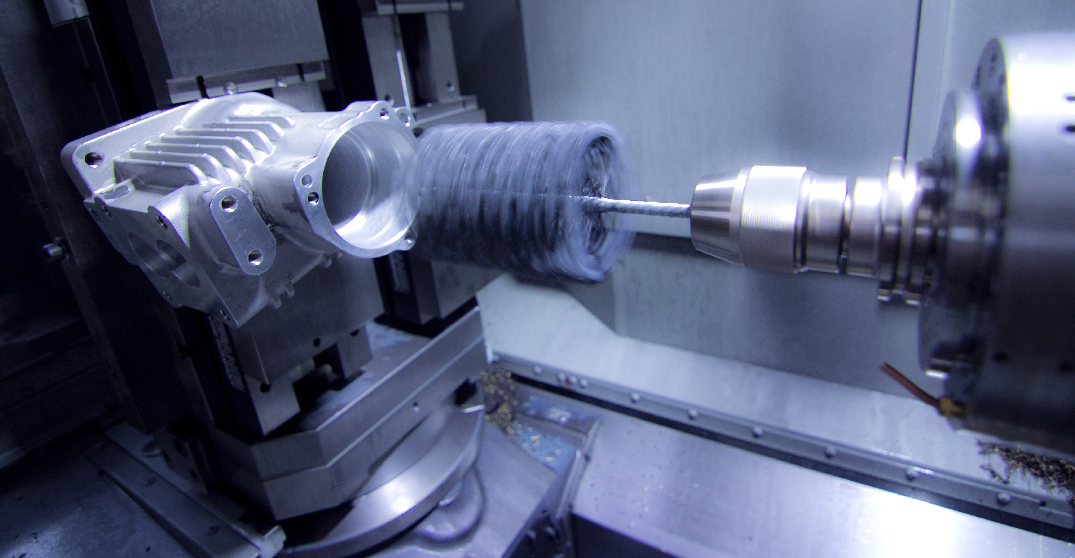

Secondary operations like honing and polishing can be automated effectively using a variety of abrasive tools mounted in a toolholder and carousel without taking the part offline. Even better news is that in addition to reducing in-shop labor requirements, completing surface finishing simultaneously, in a single operation with machining, speeds production for high-volume parts.

In addition to honing, there are various other finishing operations that can be automated using abrasive nylon brushes in disc, wheel, cup, and end-brush designs.
When an application calls for surface finishing, cleaning, polishing, deburring, edge-blending, or removing paint, rust, or other contamination, these types of tools are ideal. In some cases, the multi-purpose tools can eliminate machining operations traditionally performed by chamfer tools and face mills.

According to James Mawazeb, director of operations and lead engineer at JR Precision & Welding, the abrasive nylon fit well into the shop’s five-axis machine's magazine holder and existing toolholders. “In addition to removing the large burrs the wheel brush also provided a soft edge break to the ports, so they were not razor sharp without affecting the surface finish,” Mawazeb said.
