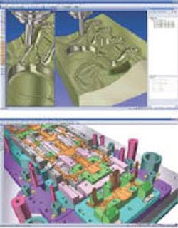

“For example, we use VISI Flow software to design accurate molds faster, and VISI Machining, for cutting steel, and high feed milling. It’s very important that we get the part right the first time. This keeps our customers happy and we enjoy repeat business because of it,” Martin said.

However, Martin has found a strategy around that caveat: “We subinsert steel shut offs or slides inside the aluminum mold design. We call this hybrid aluminum tooling, and VISI is strategic for designing such tools. Critical or small parts of the mold design can be made of steel while the rest of the design is aluminum.”

He likes the VISI machining package, too, particularly the rest milling and pencil milling. Martin explains that he wouldn’t rough out a complex block without those tools.

Over a two-day period, Martin used VISI Flow software to rework the mold gating system.
“Working with the customer and VISI Flow, we found the best gating situation for the part. I moved the gating to where I thought it would be best and used VISI Flow to confirm it. In addition, using VISI Mold we increased the mechanical integrity of the part design and strengthened the areas that needed to be stronger compared with the original Chinese designed mold. We designed and built the tool, shipped it, and as a result the mold generated high quality parts,” Martin said.
